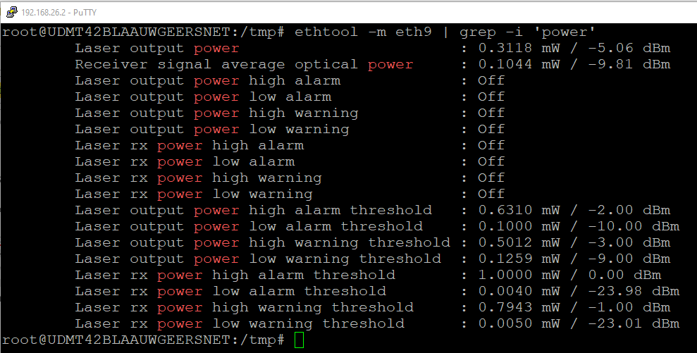

root@UDMT42BLAAUWGEERSNET:/tmp# ethtool -m eth9 | grep -i 'power'
Laser output power : 0.3118 mW / -5.06 dBm
Receiver signal average optical power : 0.1044 mW / -9.81 dBm
Laser output power high alarm : Off
Laser output power low alarm : Off
Laser output power high warning : Off
Laser output power low warning : Off
Laser rx power high alarm : Off
Laser rx power low alarm : Off
Laser rx power high warning : Off
Laser rx power low warning : Off
Laser output power high alarm threshold : 0.6310 mW / -2.00 dBm
Laser output power low alarm threshold : 0.1000 mW / -10.00 dBm
Laser output power high warning threshold : 0.5012 mW / -3.00 dBm
Laser output power low warning threshold : 0.1259 mW / -9.00 dBm
Laser rx power high alarm threshold : 1.0000 mW / 0.00 dBm
Laser rx power low alarm threshold : 0.0040 mW / -23.98 dBm
Laser rx power high warning threshold : 0.7943 mW / -1.00 dBm
Laser rx power low warning threshold : 0.0050 mW / -23.01 dBm
