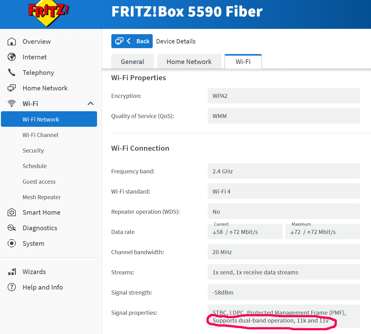

Kunnen de apparaten wel Roaming? (802.11k-v)
